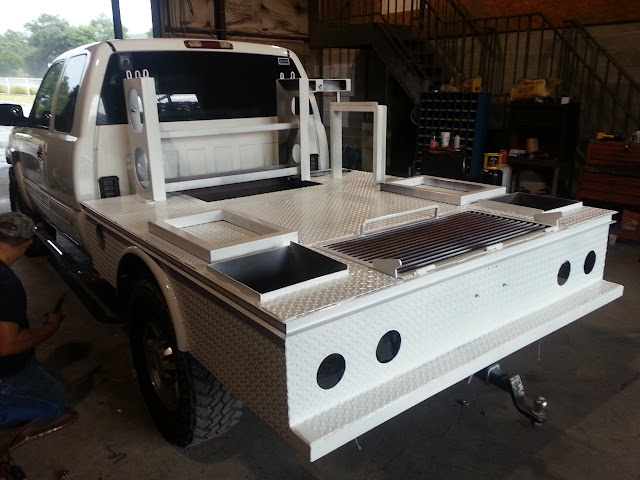

              Use the genesis industrial single stage from Sherwin Williams. It's all I use for trailers and ranch hand bumpers. Excellent color and gloss retention and it's hard as rock.
                Thats pretty looking. How much paint did you use?. Did you primer before painting?.

                  took a whole gallon and has two nice wet coats. as far as primer its not needed with this paint its meant to be applied on industrial equipment. that being said i hit a few bare metal spots with etch primer.
