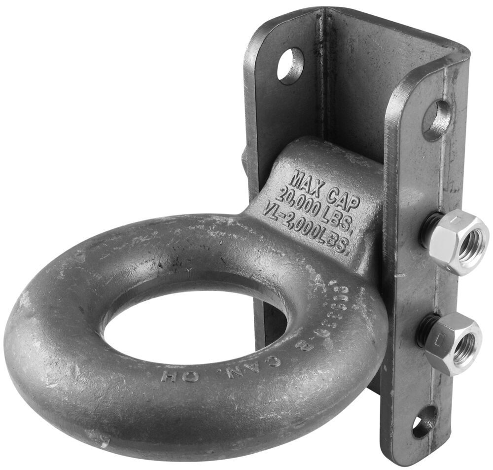

              I think some of you guys are misunderstanding what I am wanting. The 2 pics at the bottom are my trailer, as it sits now. I want to cut the current coupler off, and cut off the existing front face in order to "clean" it up and make it flush. Then I want to add what I assume will need to be 2" tubing with a hitch receiver (female side) on the front.
              The goals are:
              1. Get rid of the current coupler - It doesn't look too safe and because it sits on top of the frame it causes too much of the frame to hang below the mounting point.
              2. Extend the trailer tongue length a bit - It is a little too short for my taste.
              3. Have a hitch receiver tube on the trailer tongue - This will be used off road and I want to mount a Lunette (see pic below) for that purpose. But I still want to be able to easliy swap it to a standard coupler so I can use a standard ball hitch if needed.

                    Here, this will give you a better idea. I pretty much want this:
                    And then another coupler bolted to a length of square tube that will also fit the receiver tube.
                    It's also a decent theft deterrent. Just pull the coupler.
