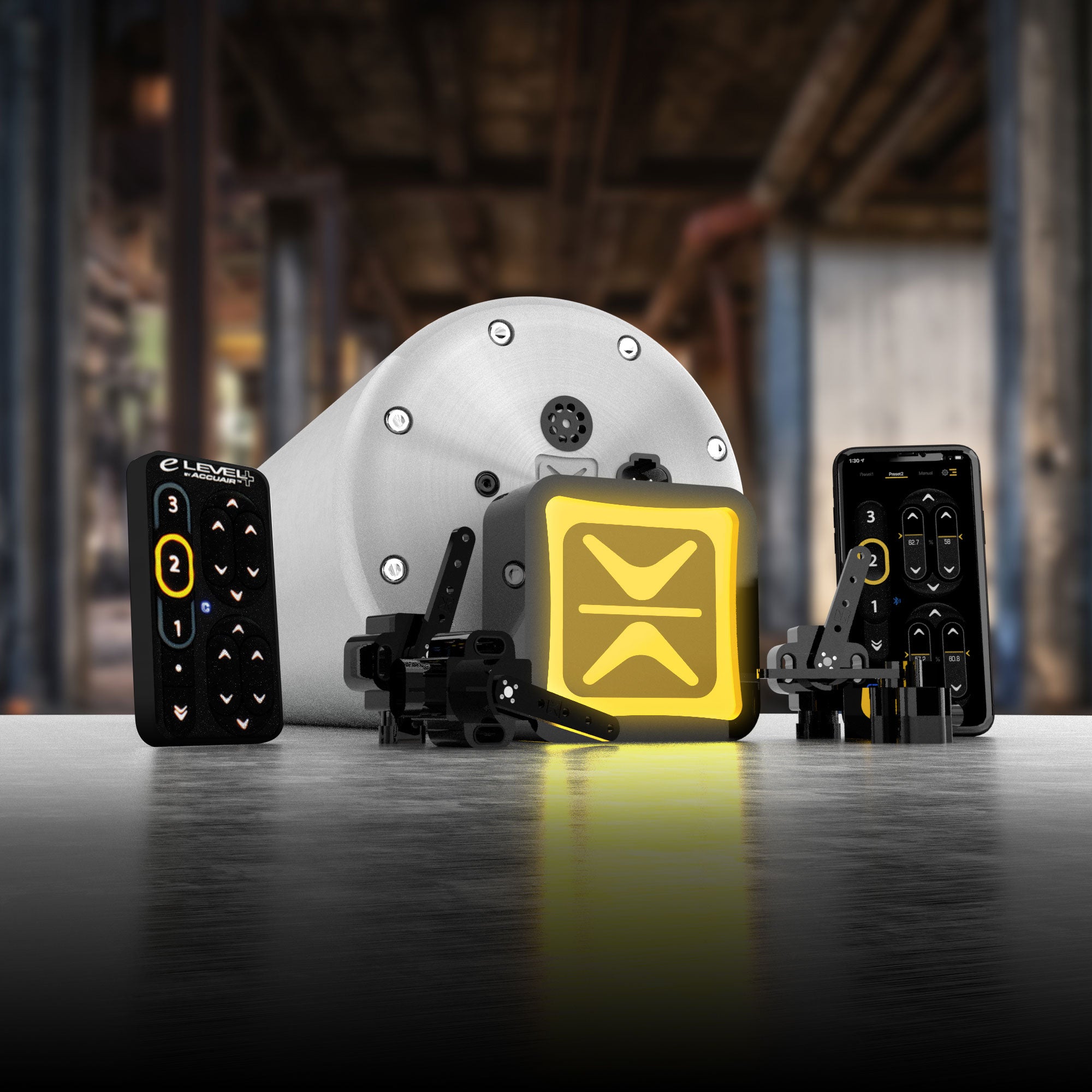

          This is the management system I want to use:
          Air suspension kits can be pieced together or bought in an all-in-one air suspension package. Here at AccuAir, we give you the option of being able to buy each component you need individually or in one of our easy-to-use air suspension kits. If you are looking to add air ride to your vehicle, choose an AccuAir air susp
