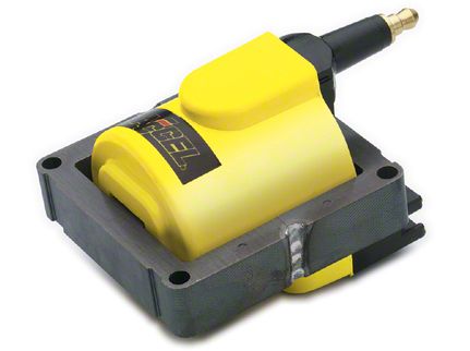

                  I found this, anyone here recommend it?
                  FREE SHIPPING! More Power. The Accel Ford TFI Supercoil makes more power then the wimpy stock oem factory coils to increase your 5.0 Mustangs throttle response,
