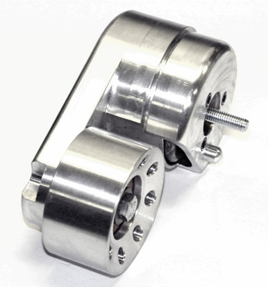

                This is probably what I need, i'll ask and see what Brian has to say.
                I like this one too, its billet and is shiny.
                • I ordered the non billet one, the billet one has some shit reviews. Probably get here the same time as my sensors on Monday. Were supposed to try and tune it again on Monday as well.
                  • The HD Tensioner came in, its a FoMoCo marine tensioner, hopefully this thing works great. Sensors should be here today.

                            I was going to get it till I read they told the customers that bought the first generation one to cut it themselves for it to work.
                            • Originally posted by abecx View Post
                              Are you serious... Do you have a link for that?!
                              • Originally posted by BoostedD1 View Post
                                Hi there.. For a fair while I have had an issue with noises from my belt at idle and also with certain types of belts namely Gates belts snapping in half on full power runs.. Yesterday I removed my Thump RRR tensioner and replaced it with my stock tensioner and there was no noise issue at all...
                                Ok I rang thump racing today about there tensioner. He said the ones that have the cut on them was an old design and that he has hundreds of these on cars with no issues. He then explained how I should go about cutting the bottom off my own... Ha. Chukarboy call them on 1862 210 8512. Now he gave me a rant that mine was the first he has ever heard off with this issue. Would be interested to see what dialogue you get from them.
                                Thump said to send it back and they would provide a relief in the spring cover to give more clearance. ... I spoke to a buddy of mine and he said that he had similar problems with the Thump and said he fixed it by changing the pulley to a smaller diameter pulley that will give more clearance. That sounds good but I would need a smaller belt and the new pulley wont be billet. I also spoke to Bruce from HHP and he said that they grind them in the shop to give more clearance.
