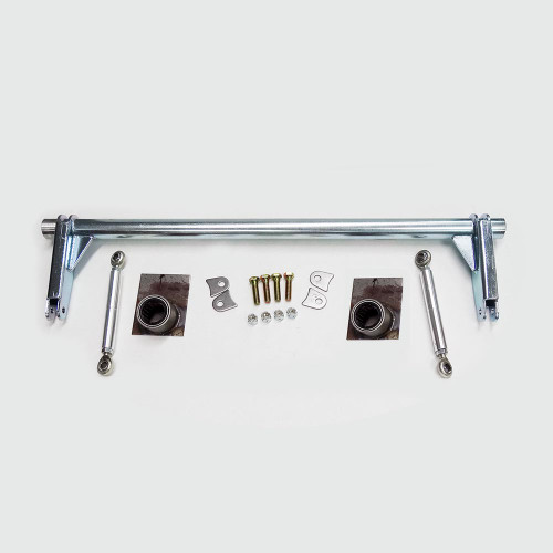

4- The anti-roll bar kits are pretty pricey, not sure I'll need one right off the bat with a massive 400hp or so, but I've never setup a car that had no sway bar/anti-roll bar of any kind. What will this do to the street manners and launching ability. Is this a must right off the bat?
