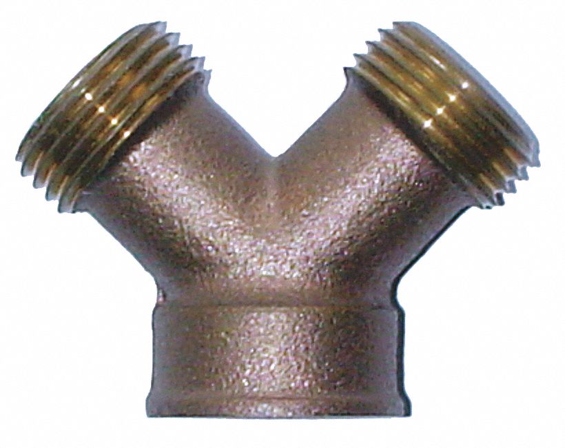

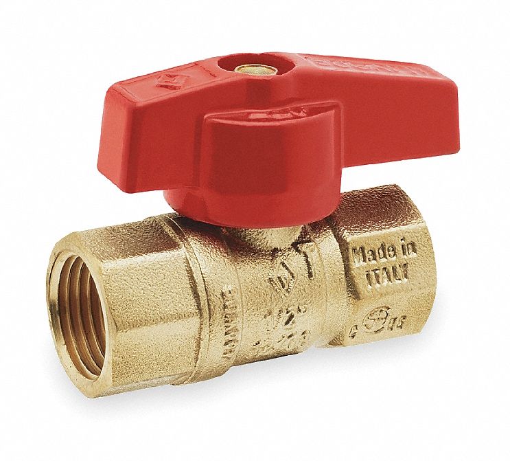

                    From the cell or tank's outlet hose
                    To a -12 to 3/4"NPT fitting
                    which would be threaded into one of two ball valves like this:
                    threaded directly to a Y fitting like this:
                    back to a -12-3/4"npt fitting
                    into the pump
                    The return would be similar except 1/2" to -8 fittings.
