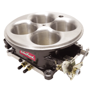

All of the other sensors seem pretty straight forward, ect, map, etc. The plan is to either have fuel injector bungs welded to his current single plane 4150 intake manifold or see if there is an existing 351C efi single plane. Then mount a 4 barrel throttle body to that (which should have tps and iac sensors). Then we'd mount the coil packs on the firewall.
