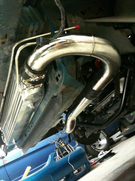

    Cold side and PS Cooler Installed
    Got the power steering cooler installed and ran most of the cold side pipe / intercooler.
    Cut a new hole in the core support for the PS cooler lines to clear the intercooler.
    I found a bracket that worked perfect to hold the lines and screwed it to the bumper. That freakin bumper is made of titanium or something, I figured it would be hard steel, but man it took 45 min for me to drill a 3/16 hole in it. Was worth it though, looks almost factory now.
    Couple pics of the pipes and IC
