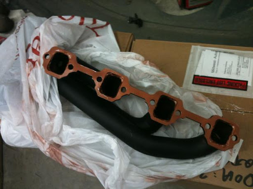

                            I decided to use the header gasket that comes with the kit and coat it and the flange with this nice spray RTV Copper.
                            I like the spray version because it goes on smooth and even.
                            Used the same stuff on the turbo flange - I decided to install the turbo after installing the header, seemed like it would be really hard to get the header on clean with all the weight on there. Worked great, just have to remember to pre-install the lower flange bolts for the turbo.
