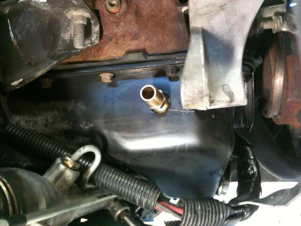

Next I punched and tapped the oil pan for the turbo drain. I found a socket that fit over the end of the tap and used a long extension and ratchet to tap the pan. Worked great to keep even pressure on the tap as it turns in the hole. Threads look nice

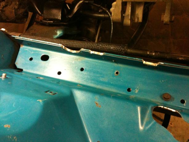

After that I started test fitting the headers to see where I am going to need to grind / cut stuff out of the way. That is when I found the pin hole in the header.
