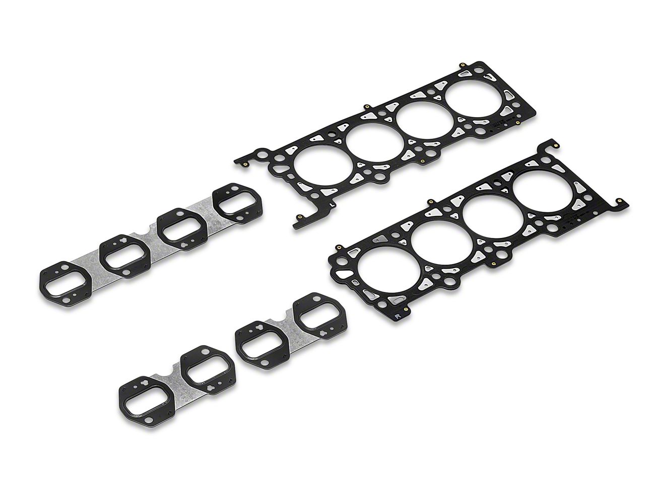

    I am doing an eaton swap on my 32v mach engine and was wondering on head gaskets. The ones found for the Mach are not recommended for S/C applications but i see see plenty of eaton swaps around without the heads being removed. Will the factory replacements hold? I am looking to getting this kit.
    FREE SHIPPING! Required For Head Swap. Make changing the cylinder heads on your naturally aspirated DOHC 4.6L easier with a Ford Racing Kit that contains all th
    All the gaskets are identical. You might want to look into arp head bolts if you have the $$$. You don't have to replace them everytime you pull the heads that way.

      Standard gaskets should do just fine.

        Thank you, the heads were taken off to get rebuilt. Also does anyone know how to time the cams on these things? I have looked online and can't find a thing. And sorry the intake was part of the deal on the purchase of the eaton swap.

            Factory gaskets are mls and of good quality. Invest in arp head bolts. Timing the cams is a detailed process.
