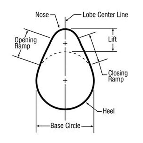

b.make sure you're on the base circle of the camshaft..now install the adj. pushrod, start at stock length

1) Follow the firing order or however you want to do it. Make sure each valve you adjust is on the base circle of the cam. As above move the pushrod up and down until it just snugs up. You've found zero lash. Now turn an additional 1/2-1 turn for preload and lock it down.
2) Repeat on all valves once again making sure you're on the base circle of the cam on each valve your setting.
