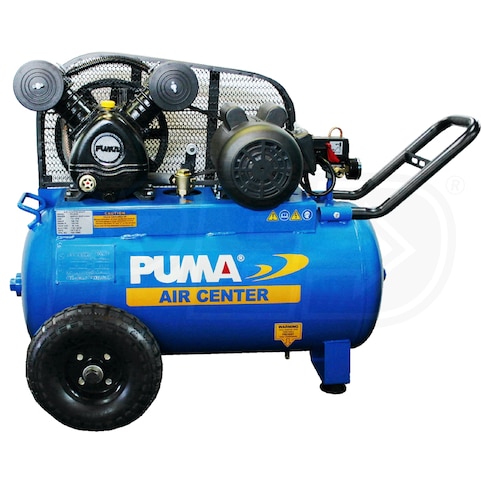

            First of all we need to know what you are going to be using? What air tools etc? I have a Pumpa 20gal tank 5hp twin cylinder cast iron pump and it is good for my impack air ratchets but it will not keep up with my digrinder. I need more CFM. Later on I'm going to buy a 2 stage unit. I'd stay away from any direct drive discount house compressors. Find one that is belt driven and has a cast iron pump on it. When you buy it do a pump up test. 0-125psi should take around 5 minutes on most units. Make sure the check valve is working properly and not leaking and make sure the pressure switch is working properly. I use to work on aircompressors for like 3 years and I never had any cast iron units come in, if they did it was because the user ran them low on oil.

                      Thats because the run at 3600rpms and are oilless most of the time. The belt driven machines run at 1750rpms and the pumps have oil. I wouldn't have one of those direct drive POS.
                      This is the unit I have and had it for the last 7 years now and not one issue and it works great. I haven't even changed the oil in it. lol Need to do that soon.
                      Buy Puma PK-5020 Direct. Free Shipping. Check the Puma 2-HP 20-Gallon (Belt Drive) Dual-Voltage Cast-Iron Air Compressor ratings before checking out.
