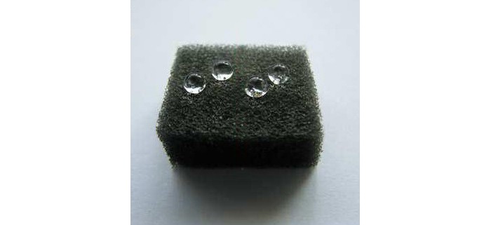

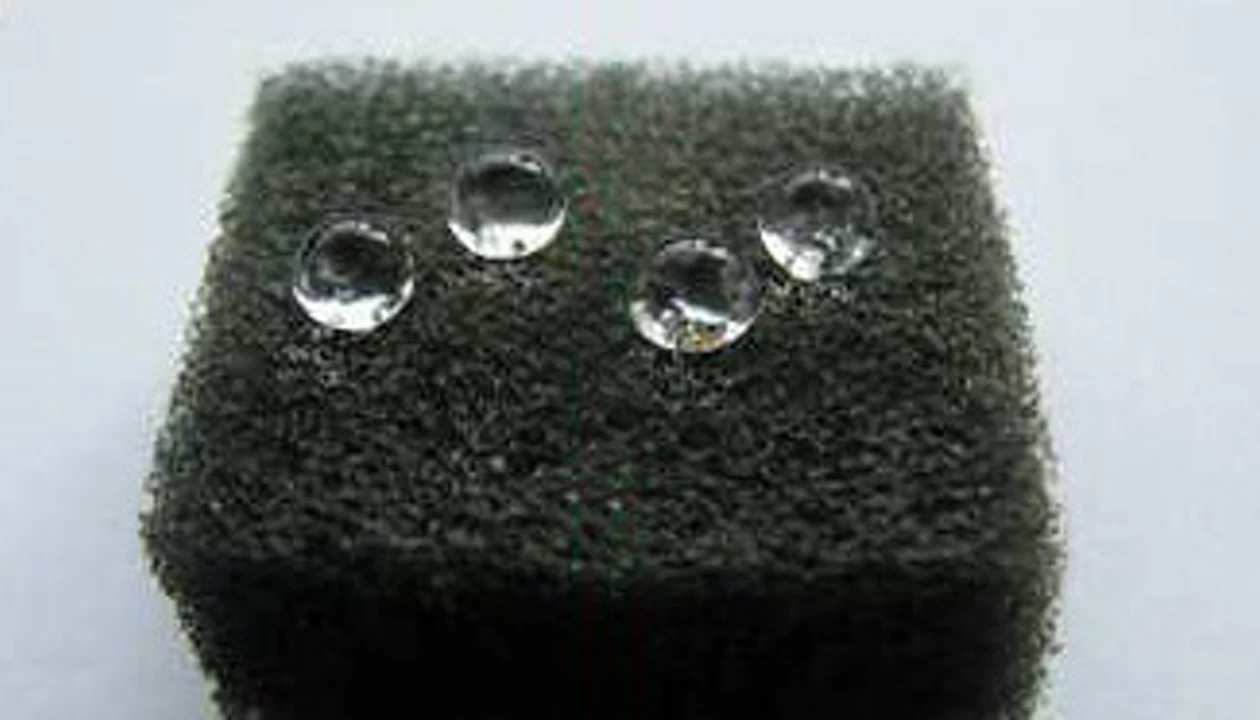

When the scientists added droplets of water to the surface of the revamped sponge, the water stayed in a bead and wasn’t absorbed. Droplets of oil, however, disappeared into the sponge immediately. The researchers also dipped the sponge into a variety of oils, including motor oil and soybean oil. The sponge sopped up more than 20 times its dry weight for each of the oils. The team tested how the sponge fared after reuse: They sopped up oil with the sponge and then wrung out the absorbed oil. After repeating those steps five times, the sponge could absorb at least 17 times its weight in oil.
