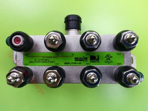

That i can buy/have? Need one asap. Has to be for an SWM, and looks like this

Originally posted by dangerous_sep View PostThat zinwell won't work with the swim set up. I know dsi in garland off of Plano rd sells them but I think they are wholesale only. Best bet is to call an installer of of craigslist and ask if they have one to sell you they don't go for much more than $14.

No, i temporarilly moved, and now moved back, and those crooks want $230 to come out and reinstall it. While i was gone, my wife had Verizon come out and hook up their stuff. Well, they changed out the splitter at the box, so i have no power to the lnb now.
Originally posted by cbrjames View PostI'll check Fys at lunch first since it's fairly close to work. If not, i'll search cl.
No, i temporarilly moved, and now moved back, and those crooks want $230 to come out and reinstall it. While i was gone, my wife had Verizon come out and hook up their stuff. Well, they changed out the splitter at the box, so i have no power to the lnb now.i.e. if it was FIOS, their is 1000mhz, but the one you showed wants 2150, which matches what the other dude was offering.

Originally posted by ceyko View PostI'm no expert, but I generally just match up the mhzi.e. if it was FIOS, their is 1000mhz, but the one you showed wants 2150, which matches what the other dude was offering.
