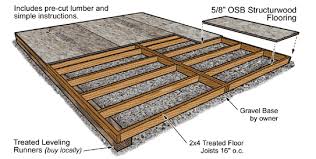

        basically something like this is what I was thinking...
          8lbs/gal. + people fornicating in a tub = an issue eventually if not done properly.
          Out of all the hot tubs I've been in, the ones with a proper slab last a very long time, while the ones without a good foundation settled weird and had all sorts of problems.
