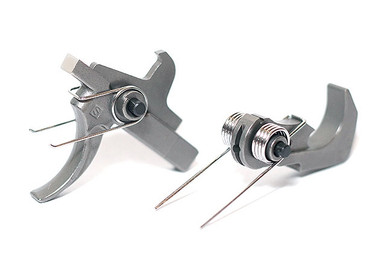

      Built on a traditional mil-spec foundation, our enhanced trigger assembly is made from 8620 steel and heat-treated with an electroless nickel Teflon finish for lubricity and protection against corrosion. Grab your assembly today and save with sale pricing!
