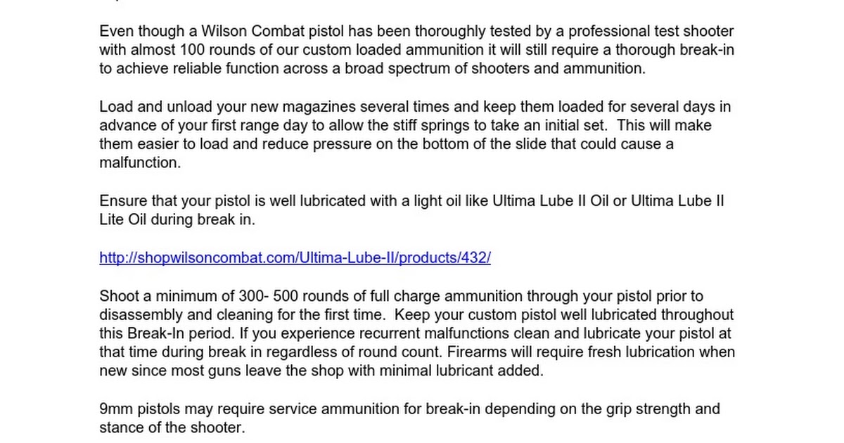

            So I started looking around at recoil springs and came across this while trying to figure out what size to order.
            Handgun FAQ 1) Breaking-In a New Custom Handgun Your new pistol is tightly fitted to very close tolerances to achieve the accuracy a 1911 is capable of. Even though a Wilson Combat pistol has been thoroughly tested by a professional test shooter with almost 100 rounds of our custom loaded amm...
            When is it time to change your recoil spring?
            • If you start getting failures to return to battery while feeding it may be an indication that your recoil spring is losing some of its overall length.
            • Typically, compact pistols will require more frequent length recoil spring changes than standard pistols.
            • If your Shok-Buff recoil buffer is becoming torn within a few hundred rounds after installation, that is also evidence that your recoil spring is ready to be replaced.
            • Any easy way to check for a worn spring is to compare your recoil spring versus a new spring of the same weight and brand. If your spring has lost approximately one-half an inch of overall length, it is time to replace your spring. To ensure this you should always have extra recoil springs of your desired weight(s) on hand.
            • Any time you buy a second-hand or older 1911 pistol, it is a good idea to bring all unknown poundage springs back to factory spec for reliable operation. New, quality springs are a cheap insurance policy against malfunctions and pistol damage.
            • If your ejection or extraction pattern suddenly changes, you may have a weakened recoil spring
            It also gives some information on how to choose the right recoil spring and also offers other advise.
