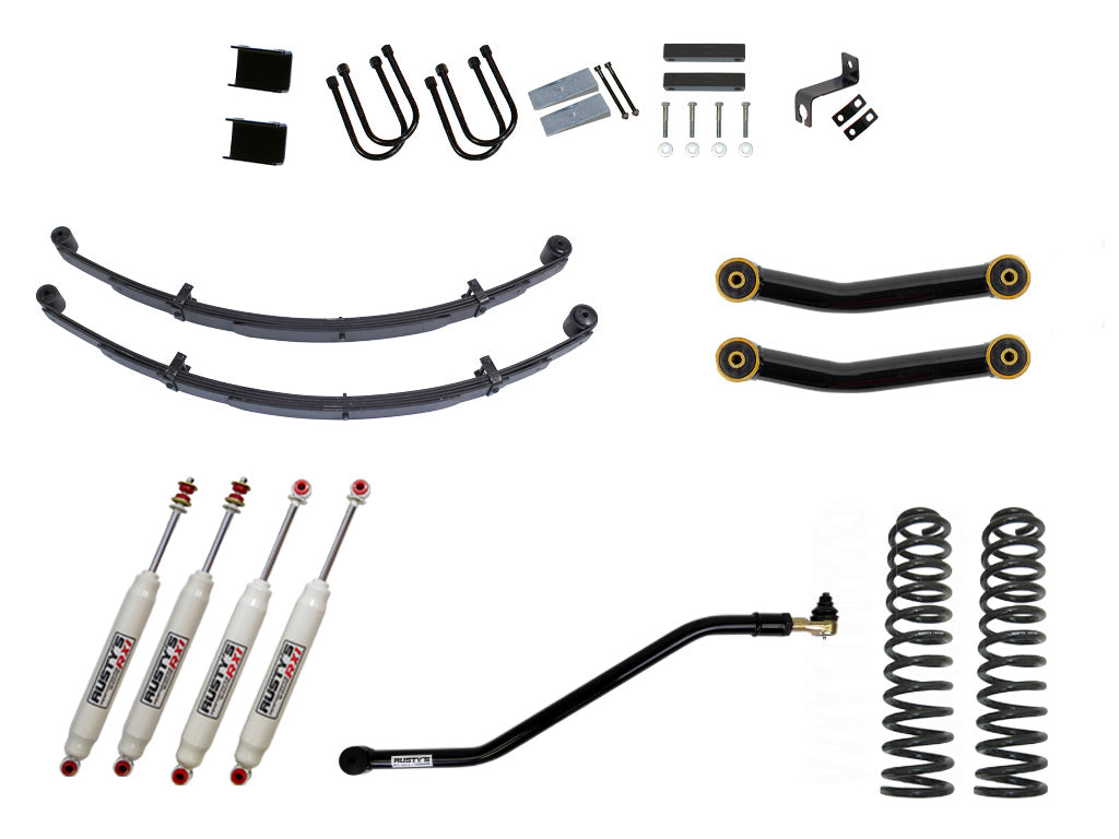

    Rusty's 4.5" lift kit with 33" tires will do you nicely. Wheels are unimportant, tires the KM2 or the mt/r kevlar tires are great.
    The Rusty's 4.5 inch suspension kit comes with everything needed to easily run 32 inch tires. It also gives you the clearance to maneuver through all types of terrain with no tire clearance problems. The addition of Rusty's Cut Out Flares will easily let you clear a set of 33 inch tires! Rusty's has put together a comp
      http://www.rustysoffroad.com/jeep-su...-pack-kit.html
      X2 I have the rustys 4.5 on my xj. It flexes decently. I'd upgrade to a decent pair of shocks bc the rustys ones that come with the kit are complete crap. Look into some OME or bilsteins. I'd also spend the extra on the adjustable lower arms.
      At 4.5 you'll also wanna do a t-case drop (I think included with the kit) or a SYE. Check out NAXJA.org and cherokeeforum
        It comes with a TC drop kit.
