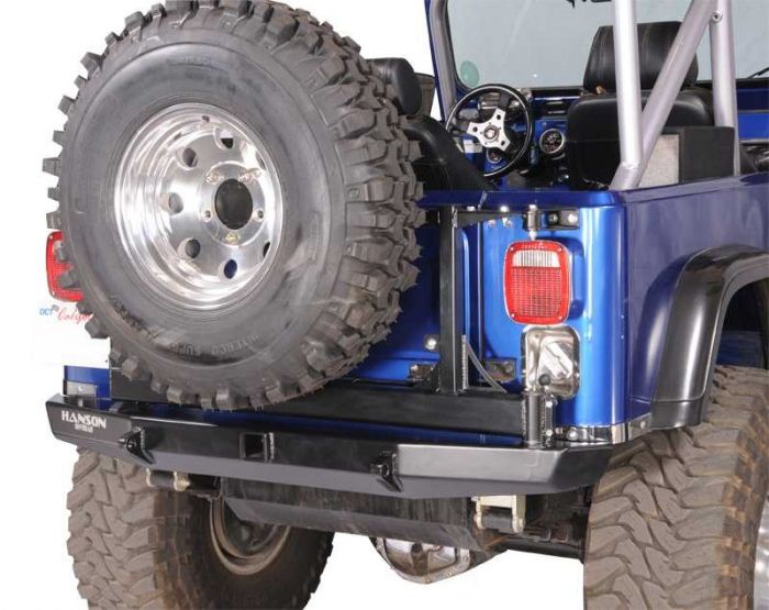

                        I know you're trying to keep this a somewhat budget build, but check out the goodies @ Hanson Enterprises
                        I had their rear bumper setup on my 2000 Sahara and it was indesctructible... Here's a pic from their site:
                        They've got some nice shorty front winch bumpers too... The project is looking good so far, especially resquaring the windshield/doors. You'll still probably need to trim a bit for 35's with the 1.25" body lift/3" suspension, unless you're just going to mudrun it. I had a 4" and 33's and a 1" puck up front to level it back out from the winch/ARB and it still came close to rubbing during some rock crawling. GL with the project...
                          Spindle looks quite delicate, TBH.
                          Check out JCR Offroad. Way cheaper than Hanson as well

                              As far as that rear mount, I like it. However, I have a welder and I know how to use it One thing I want to know though is what kind of hinge are they using exactly? Anyone know where I could find one?
                                http://www.jcroffroad.com/Merchant2/...gory_Code=SWBB
                                That pic doesn't do it justice. It's solid 2.5" or so piece of steel welded in that it clamps to with a small center bit drilled out for greasing. This also allows you to adjust how easy it swings on the spindle. The entire bumper construction is 1/4" as well, but it does weigh a ton. I had a 33" tire, high lift jack, shovel, etc mounted on it and could still stand on it, jump up/down and swing it open/shut. I had almost bought the jcoffroad version, but I didn't like 2x4 looking bumper design. The Hanson also has a pin running down the arm that locks when opened so it doesn't shut on you and I preferred the more hidden high lift mount. A lot of people use the JCR though and like it.
