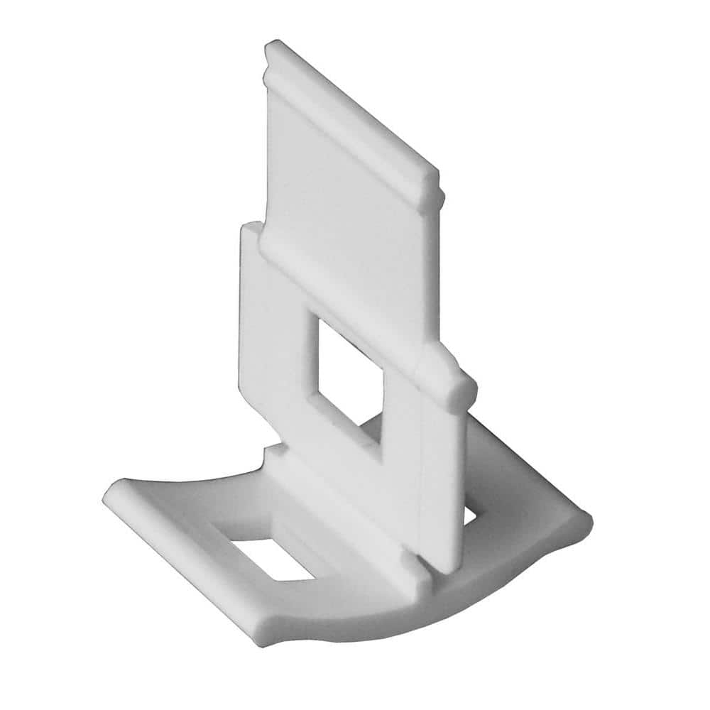

      I've also seen these in use. Seems a good saw and this system makes it almost idiot proof. I've got a tile job coming up soon and I'm going to give it a shot again using these.
        I'm about to do a bunch of tile.
          I can do a lot of things, but tile isn't one of them. I will say, a good saw makes all the difference in the world.
          http://m.homedepot.com/p/QEP-LASH-Ti...720Q/100645280
          make sure you get the pliers tool to install tighten them or your hands will hate you. I tried the "tornado" system and wasnt impressed. The simple wedges with tool looks like a simple and cheap system
