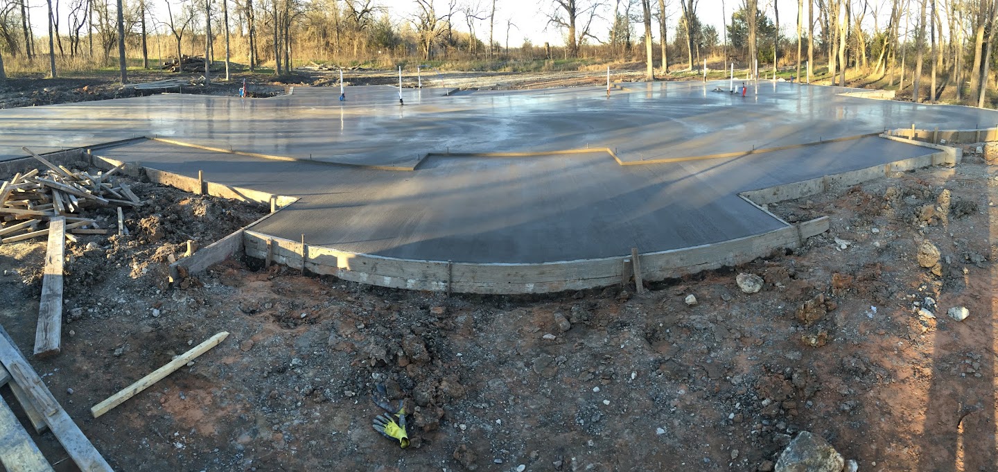

          The middle section is right around 3ft tp 3 1/2ft if I remember correctly. The left side has a bonus room above it. The right side is vaulted ceiling. See pano picture below.
          The description provided for portal framing is exactly how it was done. Additionally that explains all of the nails used in the OSB to headers and vertical framing in the corners. I don't know the brand of hold downs, but there are 2 of the threaded hold downs in the 6x2 framed walls in both x and y axis of those corners. Those hold downs were installed in all of the exterior wall sections all the way around the house. They all had metal plates, washers then nuts installed after the framing went up.
          You can see some of the hold downs in this picture.
          You can sort of make out some of the nails here. There were way more if I remember correctly once they completed the framing.

            Those are anchor bolts and not hold downs. A holdown is a big piece of metal that attaches to the studs. Some, like the ones in the image I posted, are embedded into the concrete directly. The ones in that image, which is the same image in the code, are 26" long outside the concrete and 3" wide. They require 30 nails into the strap which goes into the double studs on top of the sheathing nailing. It's a nightmare to build which is why you don't see it often. If those big embedded straps aren't there, then it probably isn't code compliant. I'd need the layout, wall line spacing, roof height, etc. to tell you exactly what is needed, but at a glance, and I've seen a lot of plans/homes, it's not.
