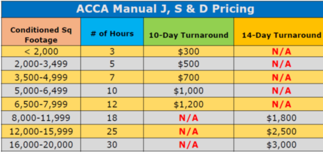

                          Not sure if you want to spend the money or if you can find a company to follow the plans, but I would look into a ManualJ and Manual D which are system design and duct design. They wont do any good if you cant find a company to follow it.

                            I have read about that. I ran through a Manual J calculator the other night, though it was a quick lets see what this is all about, run through, so it was a bit greek to me. I am not afraid to dig in and do the duct work myself, replacing the units, I would imagine that would need to be done by a licensed contractor for the warranty.
                            I may end up contacting my HVAC company and see if he would be willing to design a system for me, and I can find someone local to install.
                            • #44
                              Get a Manual J. Don't let them do a "run of thumb".

                                Im sure you will need a 5 ton a/c if you go by their calculations. This is one of those things that I believe you should get an outside company to do. A house under 2000sqft should be $150 from the company I used for the manual J and D.
                                Upfront Manual J Pricing for 10 & 14-Day Turnaround. Residential HVAC Design Wrightsoft Right-J & Right-D reports. Manual J $50 discount Coupon - Save $50 Today!
                                It was $75 for 1 hour on manual J..looks like it went up a bit. Like I said...only works if the installer follows the design.
