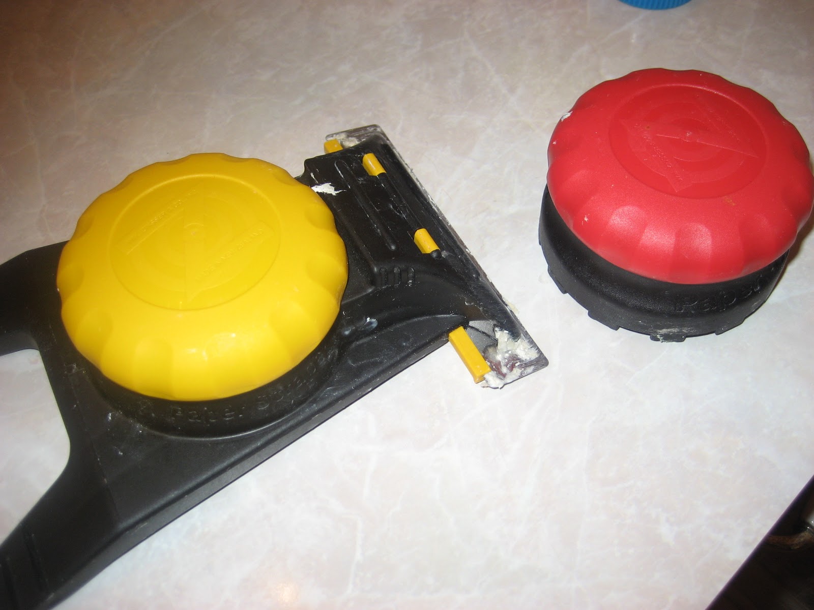

                            While in the process of the stain, we are getting new counter top and now dam the luck removing painted wallpaper. Now im trying to decide to primer over the adhesive left from the wallpaper or spend the time to try and remove it all.
                            Anyone need 4'×6' mirrors. Sweet to hang on the ceiling.
                              They make tools for removing wallpaper, i have a few pair. they also sell some chemicals that you spray on, wait 5, then start scraping. I've also heard Downy fabric softner will work the same as whatever the chemical is. Don't try and paint over the adhesive, it will look tacky as hell and can cause problems with adhesion.
                              If you'll pay shipping, i'll send you a scoring tool and a scraping tool. Can't imagine it would be more than a couple bucks. The tools are ~$20/ea
                              These are the tools i have
