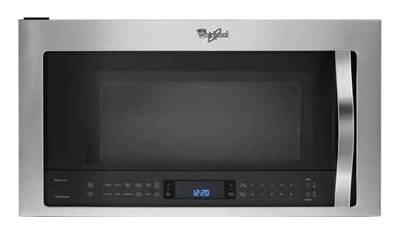

    Bought a fancy microwave to put above the oven and it has instructions to vent it but the one that I removed was just a range hood and didn't vent anywhere
    So how hard is it to add some venting to the outside? Cutting outside brick just doesn't seem all that fun.

                      Model number of microwave?

                        WMH73521CS
                          Originally posted by 03mustangdude View Post
                          WMH73521CS
                          Shows external or recirculating vent. If you are ok with it just recirculate it.

                            Reread the manual again must be missing where it says that will look again when I get home
                              page 4 of the install manual
                              The microwave oven is set for recirculation installation. For wall or
                              roof venting, changes must be made to the venting system.
                              NOTE: Skip this section if you are using recirculation installation.
                              Keep the damper assembly in case the venting method is
                              changed, or the microwave oven is reinstalled in another location
                              where wall or roof venting may be used.
                              The pic in the manual is how I remember them being. The fan is a rotatable module so it can be vented back through a wall opening, up through the roof or forward to be recirculated.
