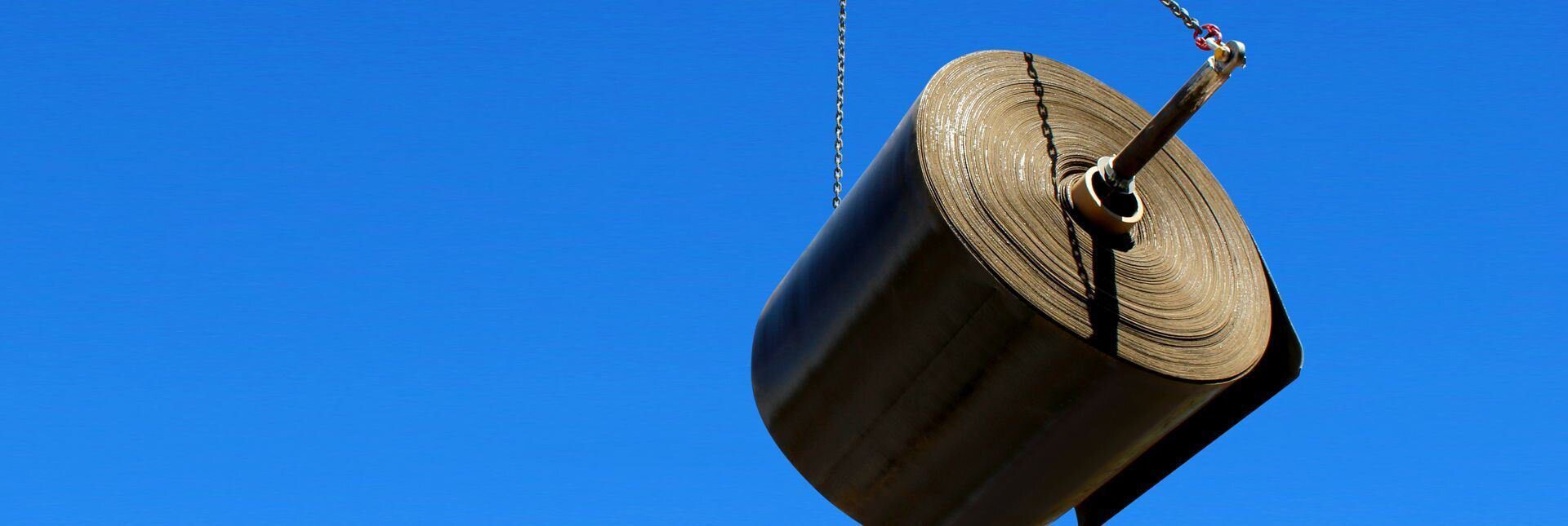

                          Have you looked into the concrete canvas shelters?
                          Created specifically for erosion control, containment and shelter applications, Concrete CanvasŪ products are part of a revolutionary class of...
                            http://www.concretecanvas.co.uk/
                            So, no. That stuff looks really cool though.
                            For an F4/F5 though I'd prefer underground and for my own preference I'd prefer actual concrete.
                            The above ground stuff, I just don't trust it holding up against a car being slung across the yard at however fast. The storm rooms that are above ground would be a lot easier to deal with - just not as safe.
                            However, glad you posted that. I can think of a million residential things it would be useful for - assuming not overly expensive. I saw some of the military uses too. I remember them refilling sandbags every month - I'd imagine that and other things it helps with.

                              Actually, I'm looking into one of these. Putting in 1/2 way under and covering it with enough soil to make it look like a hill. grass and other vegetation will grow over it in no time.
