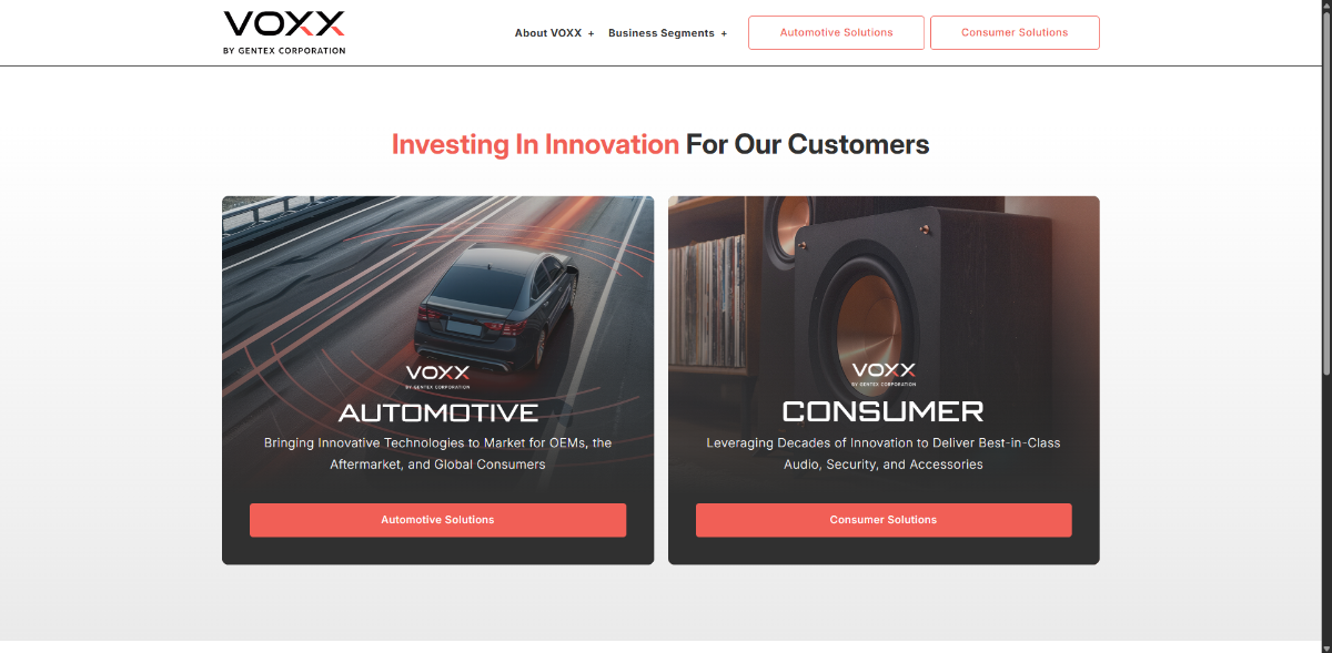

      Welcome to Voxx International. A world leader of Consumer Electronics, High Definition Audio, Automotive Security and Mobile Entertainment systems.
